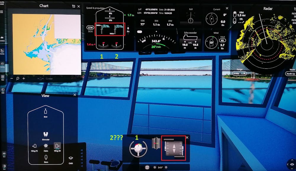

Tried Nautis Home today for the first time :) I have high hopes for it to improve over time.
Lets start with chart, it is basic and unusable for navigation as of now. There are ENC/ECDIS standards set by the IMO - link Standards in Force | IHO , needs total rework πŸ˜„

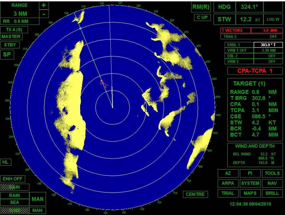

Radar also need lots of improvement, at first scale and range rings do not match any standard.
Radar has required range scales and also rings that correspond to that scale predetermined distances (for example 3 NM scale), these are the small mistakes that irritate potential customers that come from maritime backround ;)
m/v Doggerbanke - similar ship that I am currently sailing .
My remarks for now are:
Marked with red box - ship levers and indicator position do not match (PORT side lever is full ahead and STB side lever full astern )
This of ship has 2 rudders but only 1 steering wheel has been implemented by YOU.
NEEDS : 2 steering wheels and option to operate in "SYNC mode" (when sailing on open water) and in "INDEPENDENT mode" when maneuvering in port or other similar situation.

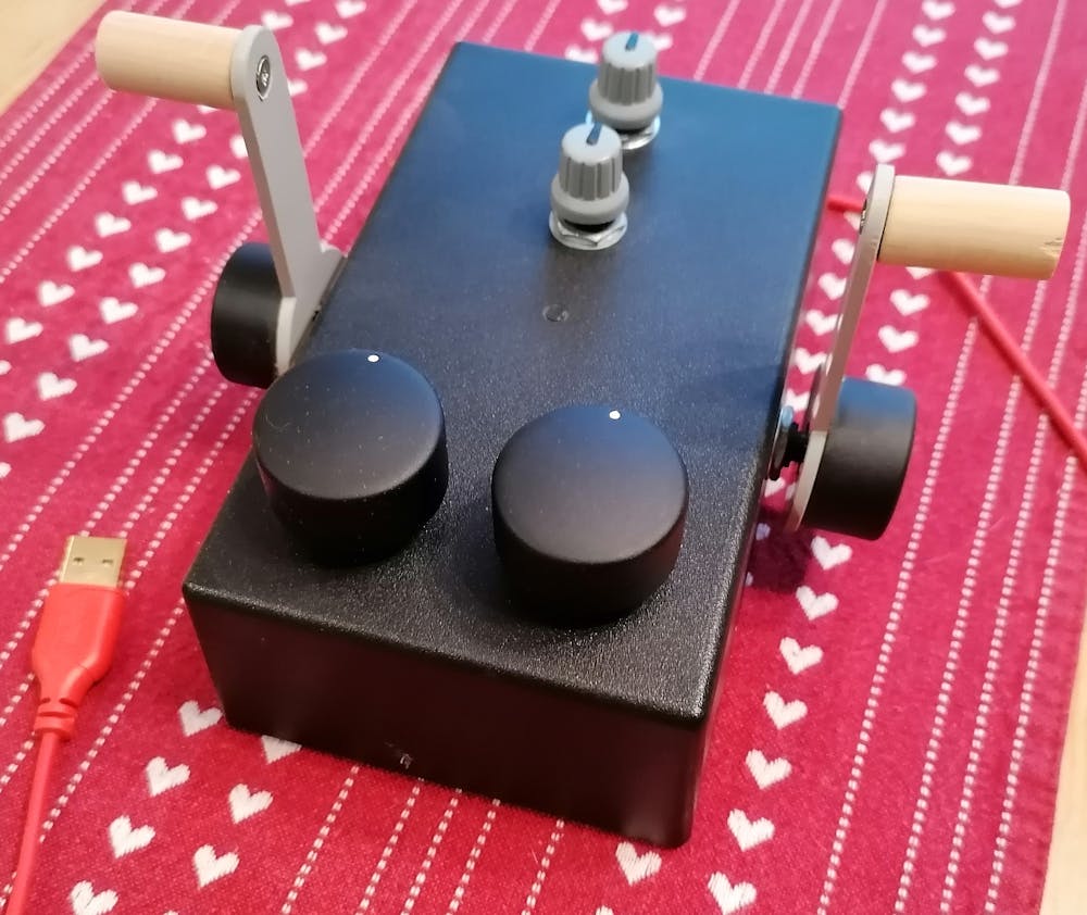

And for BONUS for inspiration and DIY guys πŸ‘
Built this simple analog controller around ShipSim Extreme time with Arduino Leonardo and 6 potentiometers ❀️ works as a HID input
